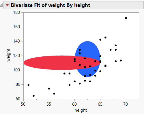

To specify the drawing order for a number of graphics elements, use an integer for the order argument to determine where each is drawn in relation to the others. The following script first adds a blue oval and then adds a red oval over the blue oval. Both ovals are behind the points.
op = dt << Bivariate(
	X( :height ),
	Y( :weight ),
Report( op )[Frame Box( 1 )] << Add Graphics Script(
	1, // draw the blue oval
	Description( "Blue Oval" ),
	Fill Color( "Blue" );
	Oval( 60, 140, 65, 90, 1 );
	2, // draw the red oval over the blue oval
	Description( "Red Oval" ),
	Fill Color( "Red" );
	Oval( 50, 120, 65, 100, 1 );
Figure 12.3 Specifying the Drawing Order

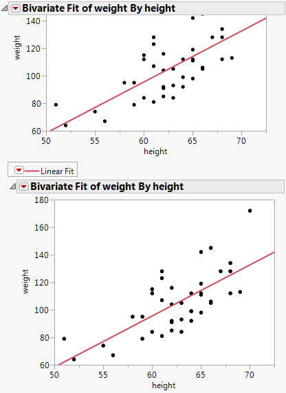

The following example creates two Bivariate graphs, adds a line of fit to the first graph, and then copies and pastes the line to the second graph.
biv = dt << Bivariate( y( :weight ), x( :height ) );
rbiv1 = biv << Report; // create a report object
rbiv2 = rbiv1 << Clone Box; // create a copy of the Bivariate graph
/* place the cloned box below the Bivariate graph
to create a second Bivariate graph */
rbiv1 << Append( rbiv2 );
framebox1 = rbiv1[Frame Box( 1 )]; /* assign references to
the reports’ frame boxes*/
framebox2 = rbiv2[Frame Box( 1 )];
biv << Fit Line; // fit a line to the first Bivariate graph
// copy the frame contents from framebox1
framebox1 << Copy Frame Contents;
// paste the frame contents to framebox2
framebox2 << Paste Frame Contents;
Figure 12.4 Copying and Pasting Frame Contents

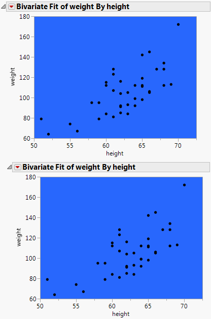

The following example creates two Bivariate graphs, sets the background of the first graph to blue, and then copies and pastes the blue background setting to the second graph:
biv1 = dt << Bivariate( y( :weight ), x( :height ) );
// create the first Bivariate graph
rbiv1 = biv1 << Report; // create a report object
framebox1 = rbiv1[Frame Box( 1 )]; /* assign a reference to the
													reports’ frame boxes */
// assign the background color to framebox1
framebox1 << Background Color( "Blue" );
// copy the frame settings from framebox1
framebox1 << Copy Frame Settings;
// paste the frame settings to framebox2
framebox2 << Paste Frame Settings;
Figure 12.5 Copying and Pasting the Background

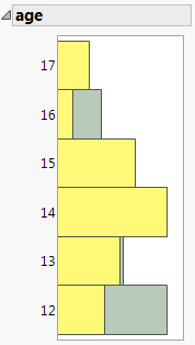

The following example shows how to create two histograms and copy the second histogram into the first histogram. A platform will not save a pasted-in segment, so you'll need to run a script like this to reproduce the graph.
dist = dt << Distribution(
	SendToByGroup( {:sex == "F"} ),
	Nominal Distribution( Column( :age ) ),
	Histograms Only,
	By( :sex ),
	SendToByGroup(
		{:sex == "M"},
		SendToReport(
			Dispatch(
				{"Distributions sex=M", "age"},
				"Distrib Nom Hist",
				FrameBox,
				{DispatchSeg(
					Hist Seg( 1 ),
// set the histogram color for males
					Fill Color( "Light Yellow" ),
For( i = 2, i <= N Items( dist ), i++,
	Report( dist[i] )[FrameBox( 1 )] << Copy Frame Contents;
// copy the the second histogram into the first histogram
	Report( dist[1] )[FrameBox( 1 )] << Paste Frame Contents;
New Window( "Distribution", Outline Box( "age", Report( dist[1] )[Picture Box( 1 )] ) );
Figure 12.6 Pasted Histogram
Pasted Histogram
