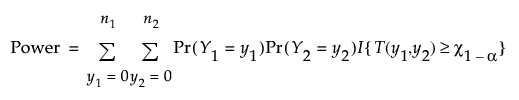

JMP calculates power under the null hypothesis as follows:
Equation shown here
where the adjusted Wald statistic is defined as follows:
Equation shown here
and:
Equation shown here and 0 otherwise
and χ1-α is the (1 - α)th quantile of the χ2 distribution.
Because there are no closed-form expressions for the ni or δ0, numerical techniques are used to solve for the ni and δ0.
