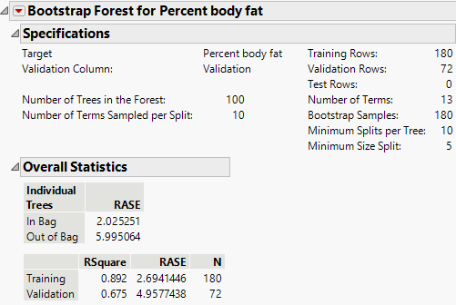

After you click OK in the Bootstrap Forest Specification window, a window appears that informs you of approximately how long it will take JMP to fit the model. If the approximated time is too long, you have the option to view the current model by selecting Accept Current Model. The Bootstrap Forest report appears after the complete model is fit or after the current model is accepted.

Figure 5.11 Bootstrap Forest Report for a Continuous Response
