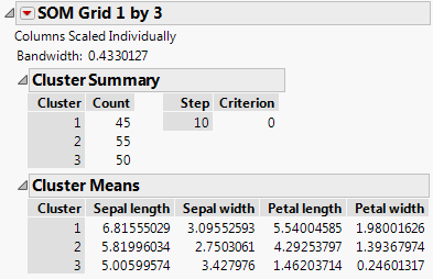

14. Scroll to the SOM Grid 1 by 3 report. We can see the classification was not perfect; each cluster should represent each species, with 50 rows for each.
Figure 13.11 Self-Organizing Map Report for Iris.jmp
