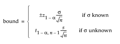

The bound is calculated as follows:
Equation shown here

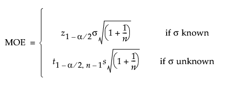

The margin of error (MOE) for prediction intervals is calculated as follows:
Equation shown here

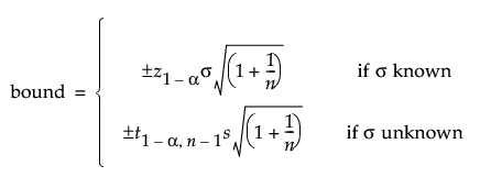

Equation shown here
