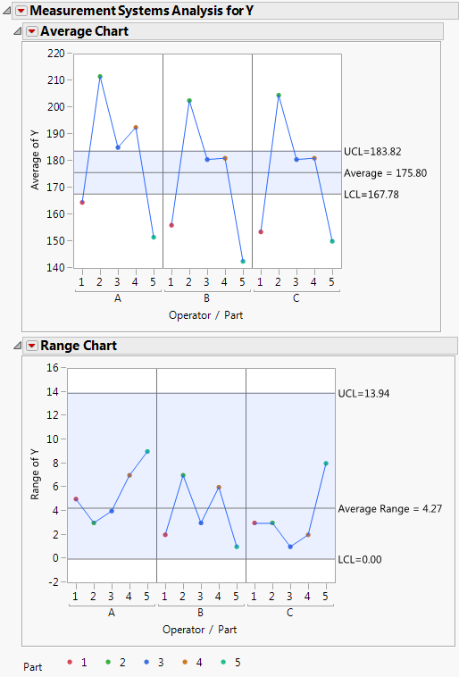

The Measurement Systems Analysis (MSA) platform assesses the precision, consistency, and bias of a measurement system. Before you can study the process itself, you need to make sure that you can accurately and precisely measure the process. If most of the variation that you see comes from the measuring process itself, then you are not reliably learning about the process. Use MSA to find out how your measurement system is performing.
This chapter covers the EMP method. The Gauge R&R method is described in Variability Gauge Charts.
Figure 4.1 Example of a Measurement System Analysis
