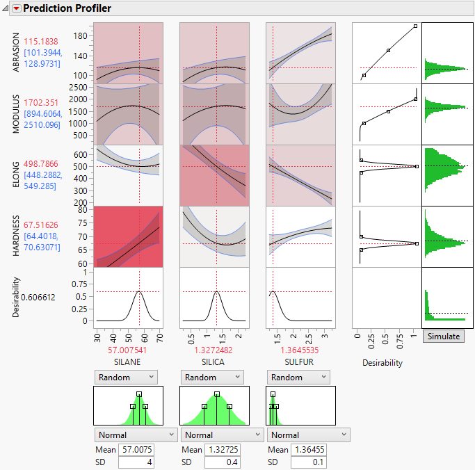

Figure 3.1 Prediction Profiler for Four Responses with Simulator and Importance Coloring
