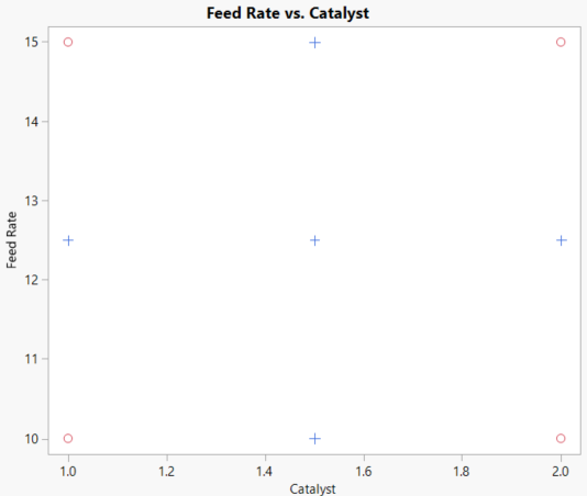

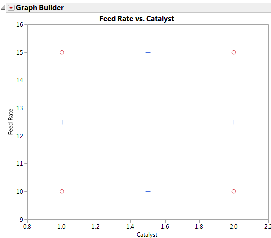

11. Select Graph > Graph Builder.
12. Drag Feed Rate to Y and drag Catalyst to X. Then click the smoother icon to remove.
Figure 6.17 Graphical View of the Augmented Design for Two Factors
The “+” points in the graph of Feed Rate versus Catalyst are the added axial and center points. The axial points are on the face of the design space. Increasing or decreasing the axial value in the augmentation of the design would move the axial points beyond or within the design space.
