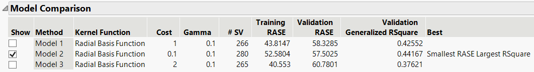

Figure 9.6 Model Comparison ReportĀ
The Model Comparison report contains the results of the models using different cost parameters. Recall that a higher cost parameter implements an algorithm that is less likely to misclassify a point, whereas a lower cost parameter implements a more flexible algorithm. In this scenario, the more flexible model (cost parameter equal to 0.1) produces the best model fit.
15. In the Show column of the Model Comparison report, deselect Model 1 and Model 3.

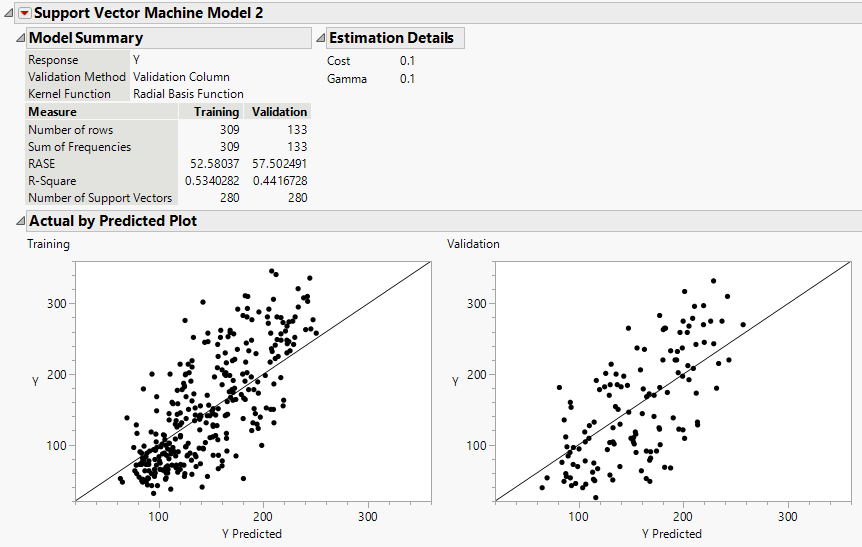

Figure 9.7 Model Report for Continuous ResponseĀ
The model report for a continuous response contains the Model Summary, Estimation Details, and Actual by Predicted Plot. In the Model Summary report, the RASE is 52.58 for the training set and 57.50 for the validation set.
