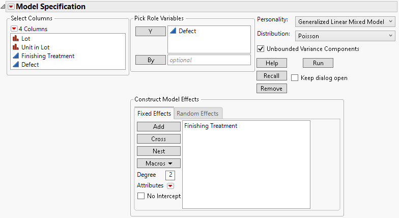

6. Select Finishing Treatment and click Add on the Fixed Effects tab.
Figure 9.9 Completed Fit Model Launch Window Showing Fixed Effects

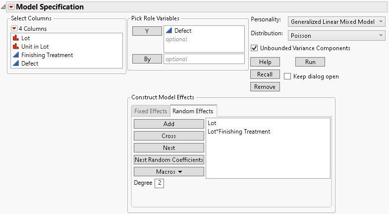

7. Select the Random Effects tab.
8. Select Lot and click Add.
9. Select Finishing Treatment from the Select Columns list, select Lot from the Random Effects tab, and then click Cross.
Figure 9.10 Completed Fit Model Launch Window Showing Random Effects Tab

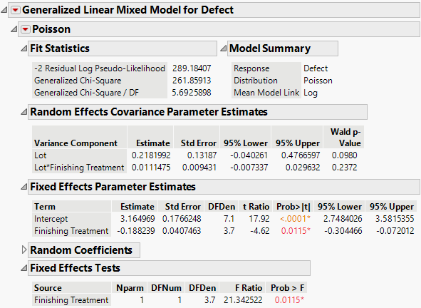

Figure 9.11 Generalized Linear Mixed Model Report Window
In the Fit Statistics section of the Generalized Linear Mixed Model report, note that the Generalized Chi-Square / DF statistic is 5.69. Since this value is much greater than 1, it is an indication that there is overdispersion in the data compared to the model. Next, you can fit a model with an additional term to account for the overdispersion.

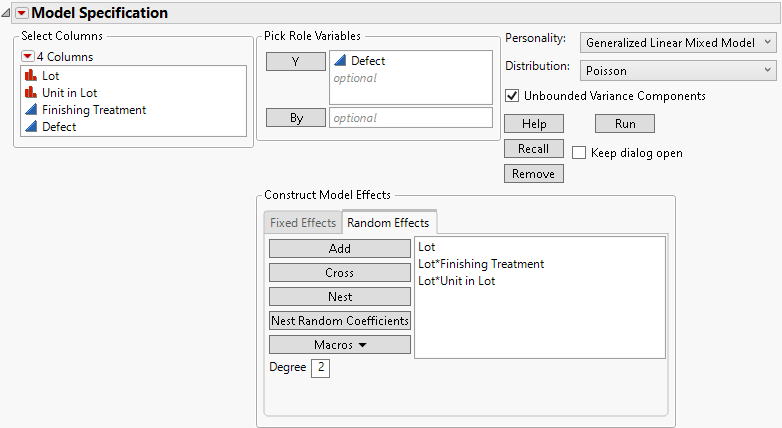

12. Select the Random Effects tab.
13. Select Unit in Lot from the Select Columns list, select Lot from the Random Effects tab, and then click Cross.
Figure 9.12 Completed Fit Model Launch Window Showing Random Effects Tab
