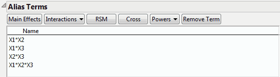

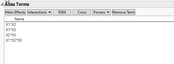

For example, suppose that you specify a design with three continuous factors. Your assumed model, specified in the Model section, contains only those three main effects. You can afford only six runs. You want to see how estimates of the main effects might be biased by active two-way interactions and the three-way interaction.
The Alias Terms table includes all two-way interactions by default. You can add the three-way interaction by selecting Interactions > 3rd.
Figure 4.21 Alias Terms
Alias Terms
