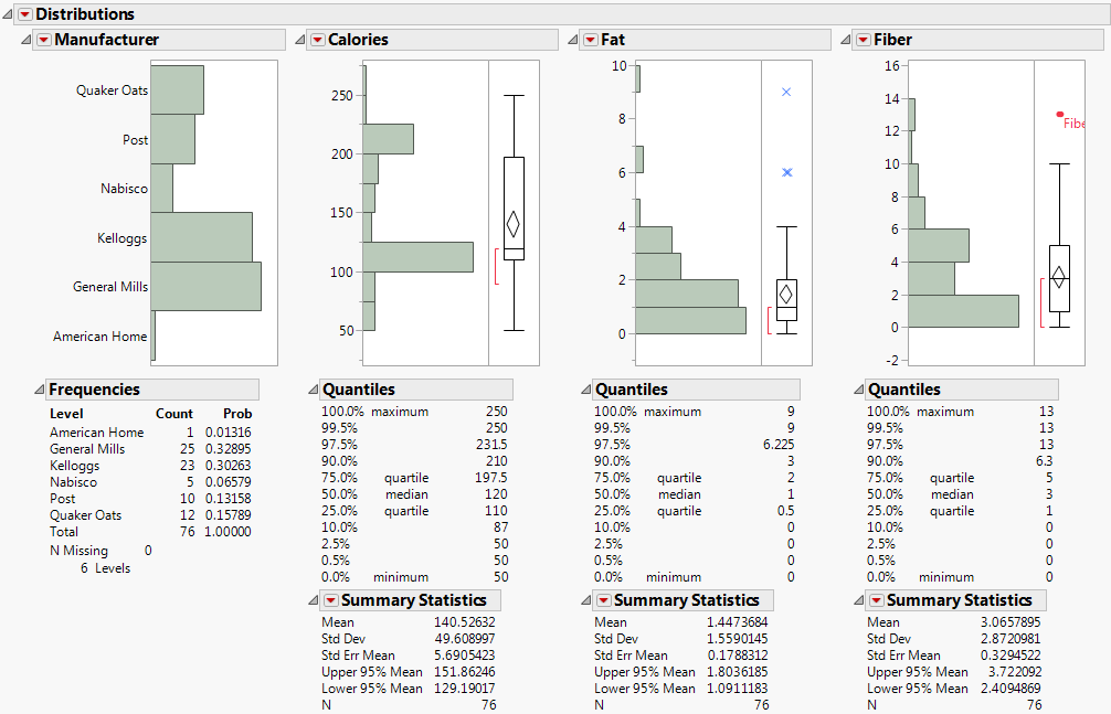

Figure 6.2 Distributions for Manufacturer, Calories, Fat, and Fiber
In the Fiber distributions, notice the following:
– Fiber One and All-Bran with Extra Fiber contain the most fiber as shown in the Fiber box plot. These cereals are outliers in terms of fiber content.
The row that contains Fiber One in Cereal.jmp is labeled. This label shows the name of the cereal next to a data point in graphs. To see the entire label, drag the right-most vertical border to the right. Hover over the unlabeled data point to see “All Bran with Extra Fiber”.
In the Fat distributions, notice the following:
– Hover over the top data point (the x marker) in the Fat box plot to see that 100% Nat. Bran Oats & Honey is the highest in fat.
– In the Fat Quantiles report, the median amount of fat is 1 gram.
In the Calories Quantiles report, notice the following:
– The maximum number of calories is 250.
– The minimum number of calories is 50.

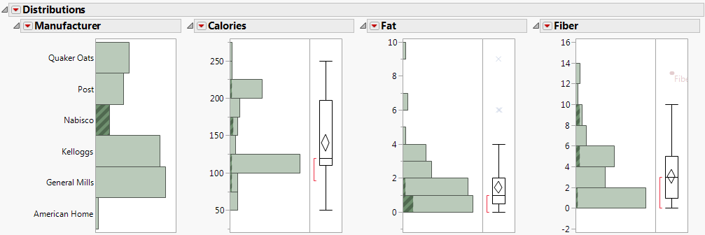

5. In the Manufacturer histogram, click the bar for Nabisco.
Figure 6.3 Distributions for Nabisco Cereals
The Calories, Fat, and Fiber distributions for Nabisco cereals are highlighted in the other histograms. You can view the Calories, Fat, and Fiber distributions for the Nabisco cereals relative to the Calories, Fat, and Fiber distributions for the overall data. For example, the Fat distribution of Nabisco cereals seems to be lower than the Fat distribution for the overall data.

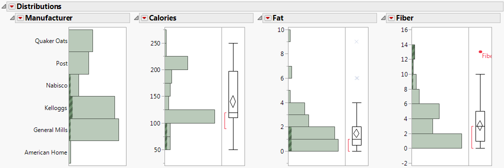

6. Click below the last Fiber bar to deselect all bars.
7. Press Shift and, in the Fiber histogram, click all histogram bars with a value above 8.
Figure 6.4 High-Fiber Cereals
High-Fiber Cereals
The highest-fiber cereals are highlighted in the Calories and Fat histograms. Because the histograms are linked, note that some of the high-fiber cereals are also low in fat.
8. Press Ctrl and Shift and deselect the two Calories histogram bars that are at or near 200.
High calorie cereals are eliminated from the histograms.
