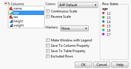

Assign Colors or Markers to Rows Based on Column Values
You can assign colors or markers to your data table rows based on the values found in a particular column. For example, in a column called Sex, you could assign all rows whose value is F a red circle marker. All rows whose value is M could have a green plus marker. These colors and markers replace the default black dot in plots and appear next to its row number in the data table.
To assign colors or markers to rows based on column values
1. Select Rows > Color or Mark by Column.
2. Select the column to color and or mark.
Figure 4.29 Color or Mark by Column
3. Select the Colors and Markers schemes to apply.
A preview of your selection appears under Row States.
4. (Optional) Select any additional options. See Color or Mark by Column Options.
5. Click OK.
6. (Optional) To shade all rows according to their row state, right-click in the row numbers area within the data grid and select Color Rows by Row State.
From then on, the rows are shaded with the color that you assign to the rows.
