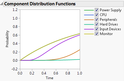

Component Distribution FunctionsSelect Show Component Distribution Functions to show an overlay plot of the distribution functions for the components of the Reliability Block Diagram.
Figure 12.24 Component Distribution Functions

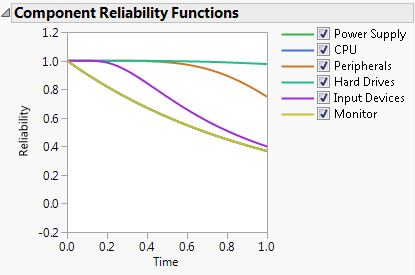

Component Reliability FunctionsSelect Show Component Reliability Functions to show an overlay plot of the reliability functions for the components of the Reliability Block Diagram.
Figure 12.25 Component Reliability Functions

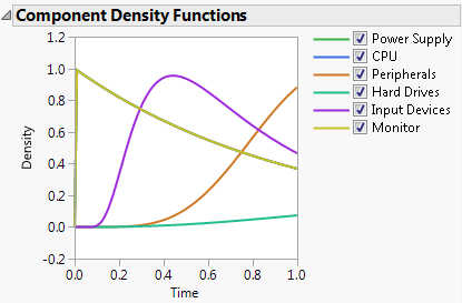

Component Density FunctionsSelect Show Component Density Functions to show an overlay plot of the density functions for the components of the Reliability Block Diagram.
Figure 12.26 Component Density Functions

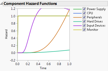

Component Hazard FunctionsSelect Show Component Hazard Functions to show an overlay plot of the hazard functions for the components of the Reliability Block Diagram.
Figure 12.27 Component Hazard Functions

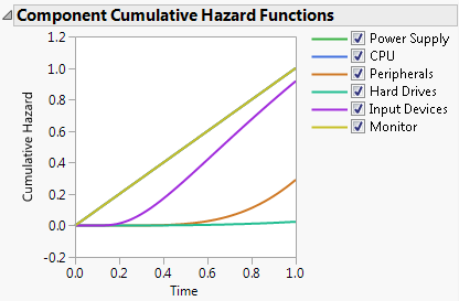

Component Cumulative Hazard FunctionsSelect Show Component Cumulative Hazard Functions to show an overlay plot of the cumulative hazard functions for the components of the Reliability Block Diagram.
Figure 12.28 Component Cumulative Hazard Functions
