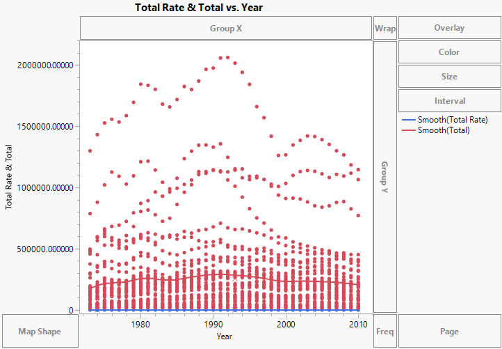

Figure 3.14 Total Rate and Total MergedÂ
The Total Rate values are all between 0 and 1, and they are barely visible. Calculate yearly means and then use a second Y axis to make these values visible.

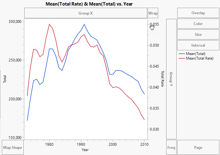

7. Right-click the variable names in the Y zone and select Move Right > Total Rate.
Figure 3.15 Second Y Axis AddedÂ
An axis for Total Rate is added on the right, and the axes rescale to show both sets of values. You can now see relationships between the two measures. For example, both measures began to decrease in 1991.
