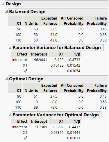

After entering you accelerated life test (ALT) specification, click Make Design to create an optimal ALT design. A balanced design is provided for comparison. There is a design report and a design diagnostic report to use for evaluating your ALT design.

The design report contains a balanced design in addition to the optimal design. The optimal design allocates units to provide the best estimates of failure rates. Compare the variance estimates of the two designs to evaluate the trade off of using a logistically more complex optimal design to the balanced design.

Design
Shows tables for both a balanced and the optimal design. For a single factor, the first column gives the levels of the factor. For two factors, the first two columns give the levels of the factors.
N Units
The number of units to be tested at each combination of acceleration levels.
Expected Failures
Expected number of failures for the design setting. The expected number is computed using the prior model specification.
All Censored Probability
Probability that none of the units tested at the combination of acceleration levels fail. The probability is computed using the prior model specification.
Failure Probability
The expected probability of failure for the design settings. The failure probability is calculated as the expected failures divided by the number of units on test.
Note: The expected failures and censoring probabilities enable you to judge whether your prior specifications are reasonable.
Parameter Variance for Balanced Designs
Provides a matrix proportional to the covariance matrix for the estimates of the acceleration model parameters for the balanced design.
Denote the matrix of first partial derivatives of the model with respect to the parameters, θ, by X. Denote the error variance by σ2. Under general conditions, the least squares estimator of θ is asymptotically unbiased with asymptotic covariance matrix as follows:
Equation shown here
The Parameter Variance for Balanced Design section gives (X‘X)-1, where derivatives are calculated numerically. The calculation assumes that the values specified in the Prior Mean section are the true parameter values.
See Statistical Details for Nonlinear Models.
Parameter Variance for Optimal Design
Shows a matrix proportional to the covariance matrix for the estimates of the acceleration model parameters for the optimal design. The calculation assumes that the values specified in the Prior Mean section are the true parameter values.
Note: Compare the values in the Parameter Variance for Optimal Design matrix to those in the Parameter Variance for Balanced Design matrix to determine the extent to which the optimal design reduces the variance of estimates.
