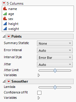

For each element that you add to a graph, an outline appears in the Properties area at left. This is where you specify and change properties for each element type.
Figure 3.23 Properties Areas for Points and Smoother

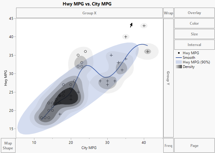

Select Multiple Elements at Once
To select and overlay multiple elements, hold down the Shift key and click the elements. Alternatively, you can drag the elements into the graph one at a time.
Figure 3.24 Graph Showing Points, Smoother, Ellipse, and Contour Elements
