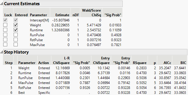

6. Click Run.
7. Click Go.
Figure 5.21 Logistic Stepwise ReportĀ
The two variables Weight and Runtime are entered into the model based on the Stopping Rule.

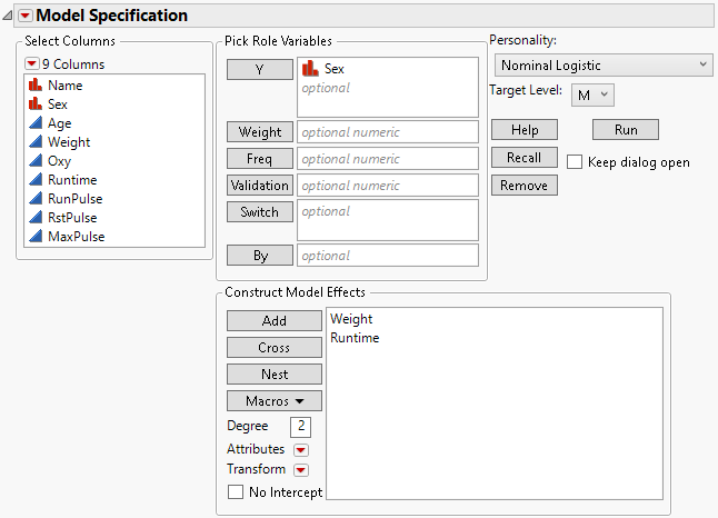

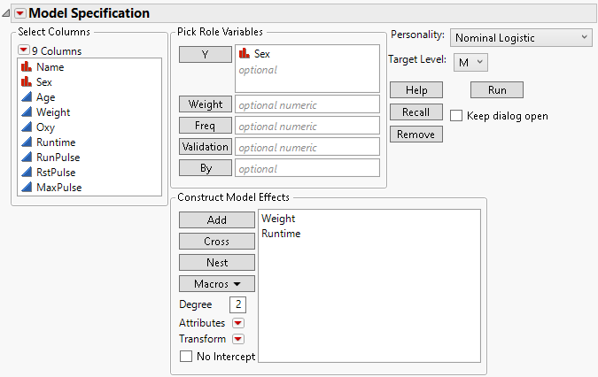

8. Click Make Model.
Figure 5.22 Model Specification Window for Reduced ModelĀ
A model specification window appears containing the two variables as model effects. Note that the Personality is Nominal Logistic. If the response had been ordinal, the Personality would be Ordinal Logistic.
