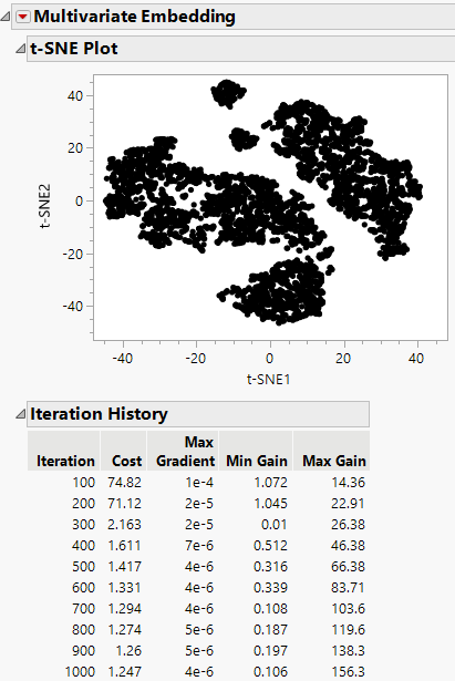

6. Click the gray triangle next to Iteration History.
Figure 11.2 Multivariate Embedding ReportĀ
The Multivariate Embedding report window contains a plot of the two dimensions computed using the t-SNE method and information about the iteration history.
