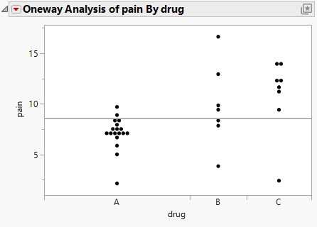

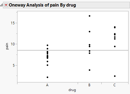

Figure 6.2 Example of Oneway Analysis
You notice that one drug (A) has consistently lower pain scores than the other drugs. You also notice that the x-axis ticks are unequally spaced. The length between the ticks is proportional to the number of scores (observations) for each drug.

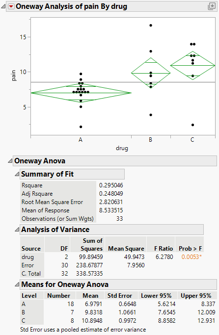

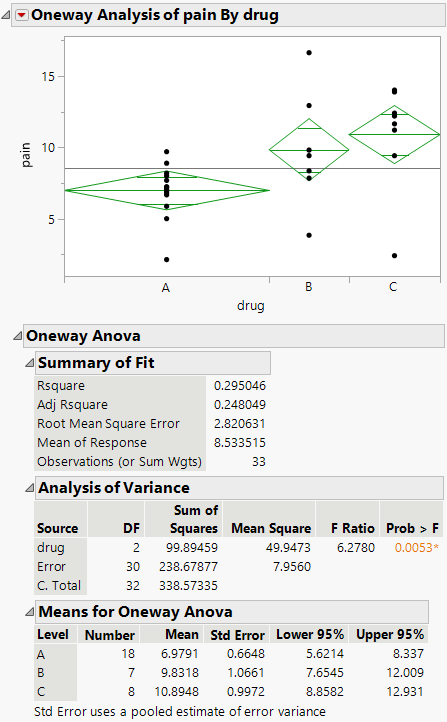

6. Click the Oneway Analysis red triangle and select Means/Anova.
Note: If the X variable has only two levels, the Means/Anova option appears as Means/Anova/Pooled t, and adds a Pooled t test report to the report window.
Figure 6.3 Example of the Means/Anova Option
Note the following observations:
• Mean diamonds representing confidence intervals are added to the plot.
– The line at the center of each diamond represents the group mean. At a glance, you can see that the mean for drug A is lower than the means for drugs B and C.
– The vertical span of each diamond represents the 95% confidence interval for the mean of each group.
See Mean Diamonds and X-Axis Proportional.
• The Summary of Fit table provides overall summary information about the analysis.
• The Analysis of Variance report shows the standard ANOVA information. You notice that the Prob > F (the p-value) is 0.0053, which supports your visual conclusion that there are significant differences between the drugs.
• The Means for Oneway Anova report shows the mean, sample size, and standard error for each level of the categorical factor.
