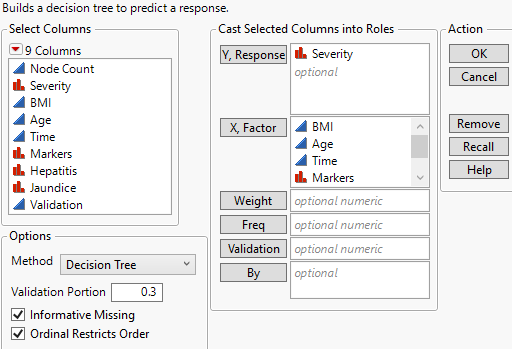

1. Select Help > Sample Data Folder and open Liver Cancer.jmp.
2. Select Analyze > Predictive Modeling > Partition.
3. Select Severity and click Y, Response.
4. Select BMI through Jaundice and click X, Factor.
5. Select a validation procedure based on your JMP installation:
– For JMP Pro, select Validation and click Validation.
– For JMP, enter 0.3 as the Validation Proportion.
Note: Results using the validation proportion can differ from those shown here, due to the random selection of validation rows.
Figure 4.17 Completed Launch Window with Validation Portion = 0.3
6. Click OK.

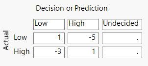

9. Click the red triangle next to Partition for Severity and select Specify Profit Matrix.
10. Change the entries to the following values:
– Enter 1 in the High, High box.
– Enter -5 in the High, Low box.
– Enter -3 in the Low, High box.
– Enter 1 in the Low, Low box.
Figure 4.18 Completed Profit Matrix
Tip: You can save this profit matrix as a column property for use in later analyses. Select the check box “Save to column as property” at the bottom of the profit matrix window.
Note the following:
– Each value of 1 reflects your profit when you make a correct decision.
– The -3 value indicates that if you classify a Low severity patient as High severity, your loss is 3 times as much as the profit of a correct decision.
– The -5 value indicates that if you classify a High severity patient as Low severity, your loss is 5 times as much as the profit of a correct decision.
11. Click OK.

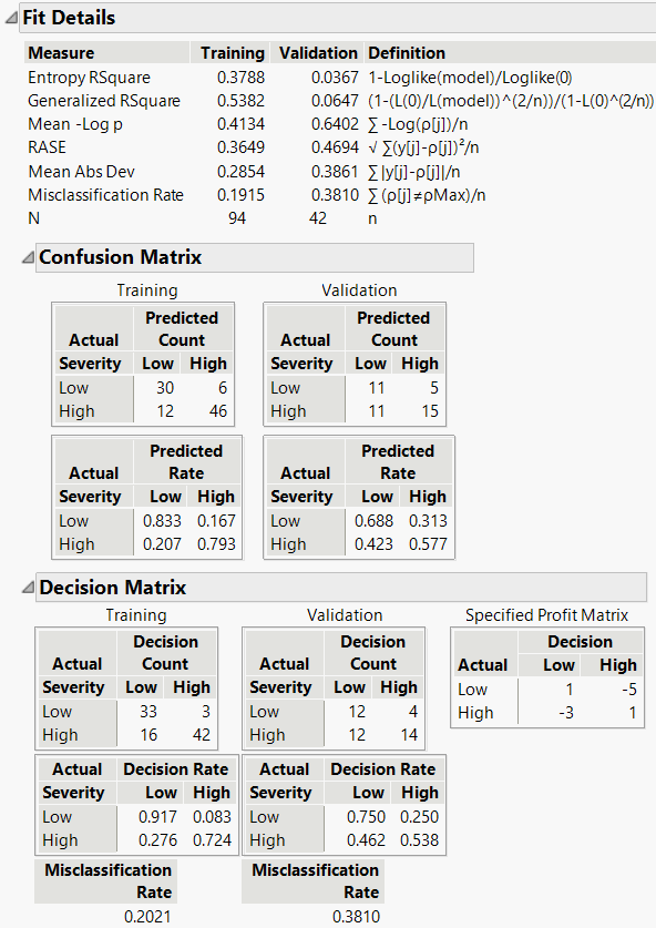

12. Click the red triangle next to Partition for Severity and select Show Fit Details.
Figure 4.19 Confusion Matrix and Decision Matrix Reports
The Confusion Matrix and Decision Matrix reports follow the list of Measures in the Fit Details report. Notice that the Confusion Matrix report and the confusion matrices in the Decision Matrix report show different counts. This is because the weighting in the profit matrix results in different decisions than do the predicted probabilities without weighting.
13. Click the red triangle next to Partition for Severity and select Save Columns > Save Prediction Formula.
Eight columns are added to the data table.
Tip: To quickly return to the data table, click the View Associated Data icon Image shown here in the bottom right corner of the report window (Windows) or the Show Data Table icon on the tool bar menu (macOS).
– The first three columns involve only the predicted probabilities. The confusion matrix counts are based on the Most Likely Severity column, which classifies a patient into the level with the highest predicted probability. These probabilities are given in the Prob(Severity == High) and Prob(Severity == Low) columns.
– The last five columns involve the profit matrix weighting. The column called Most Profitable Prediction for Severity contains the decision based on the profit matrix. The decision for a patient is the level that results in the largest profit. The profits are given in the Profit for High and Profit for Low columns.
