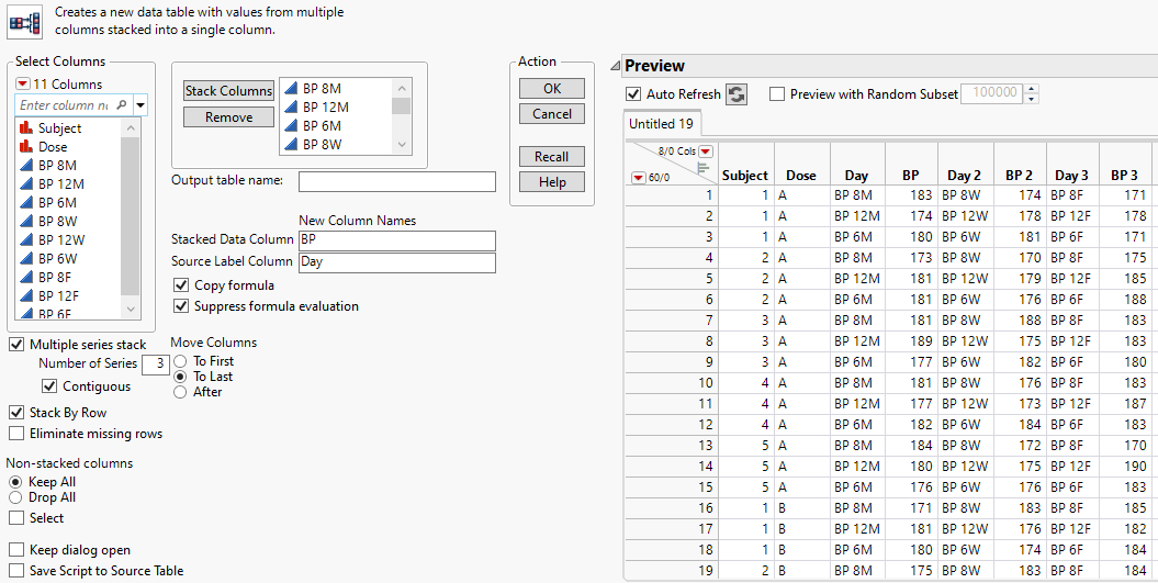

Figure 6.9 Completed Stack Window
9. Click OK.
In the stacked data table, note the following:
• The first Day column represents Monday.
• The Day 2 column represents Wednesday.
• The Day 3 column represents Friday.
