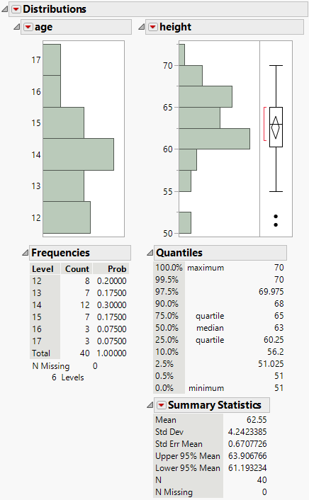

In this example, you have data on the ages and heights of 40 students. You want to visualize the distribution of the variables and find outliers in those distributions.
1. Select Help > Sample Data Folder and open Big Class.jmp.
2. Select Analyze > Distribution.
3. Select age and height and click Y, Columns.
4. Click OK.

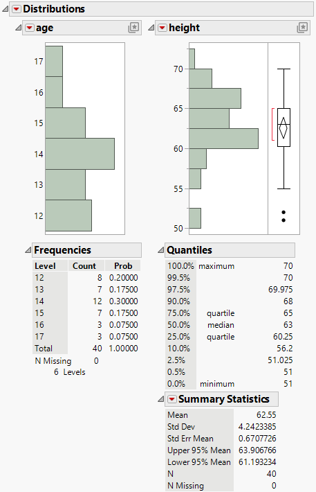

Figure 3.2 Example of the Distribution Platform
From the histograms, you notice the following:
• The ages are not uniformly distributed.
• For height, there are two points with extreme values (that might be outliers).

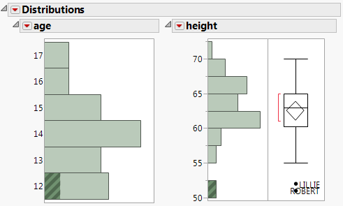

Click the bar for 50 in the height histogram to take a closer look at the potential outliers.
• The corresponding ages are highlighted in the age histogram. The potential outliers are age 12.
• The corresponding rows are highlighted in the data table. The names of the potential outliers are Lillie and Robert.

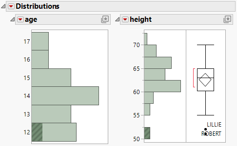

Add labels to the potential outliers in the height histogram.
1. Select both outliers.
2. Right-click one of the outliers and select Row Label.
Label icons are added to these rows in the data table.
3. Resize the box plot wider to see the full labels.
Figure 3.3 Potential Outliers Labeled
