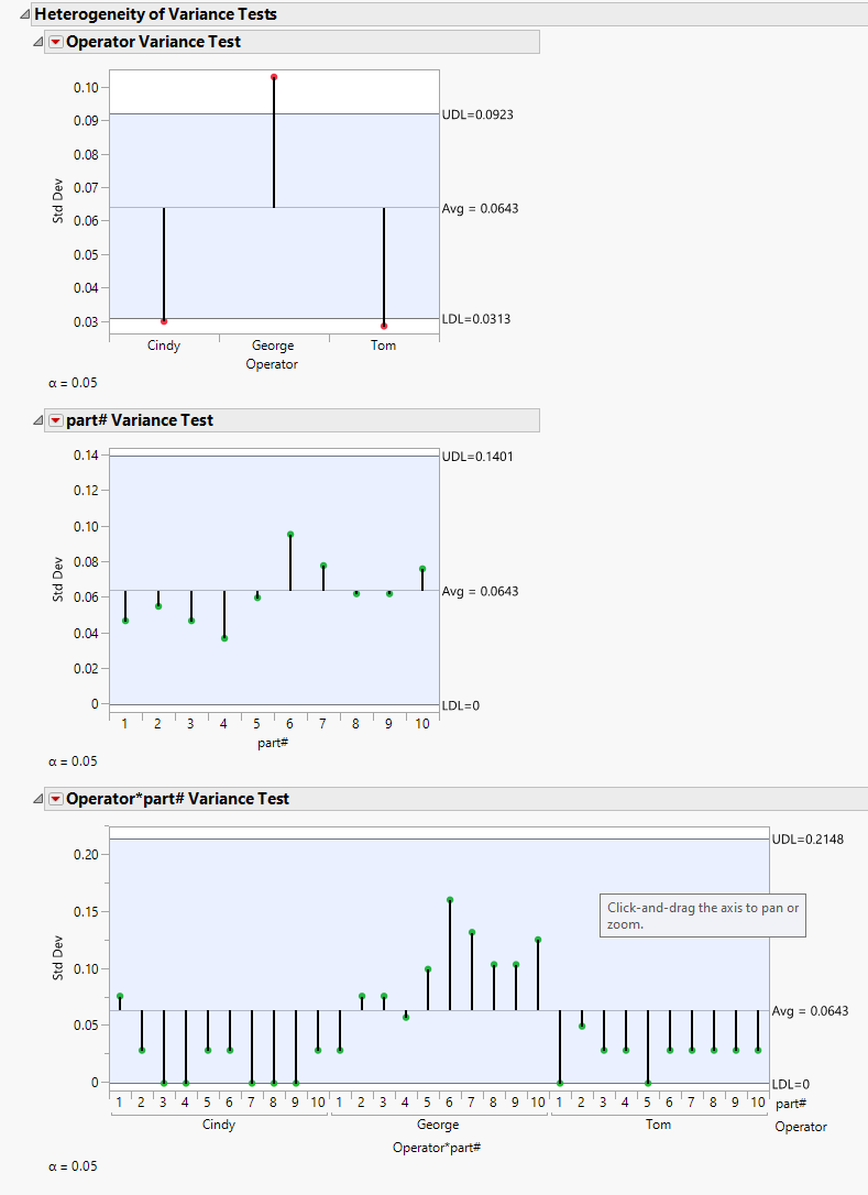

8. Click the Variability Gauge Analysis for Measurement red triangle and select Heterogeneity of Variance Tests.
9. Select Crossed.
10. Click OK.
Figure 6.10 Heterogeneity of Variances Tests Report
In the Operator Variance test, all three levels exceed the upper and lower decision limits. From this, you conclude that each operator has a different variability from the square root of the average group variance. You might want to examine why the variation between each operator is different.
For the part# Variance test and the interaction (Operator*part#) Variance test, none of the levels exceed the decision limits. From this, you conclude that the variances are not statistically different from the square root of the average group variance. Each part has a similar variance to the other parts, and each Operator*part# combination has similar variance to the other Operator*part# combinations.
