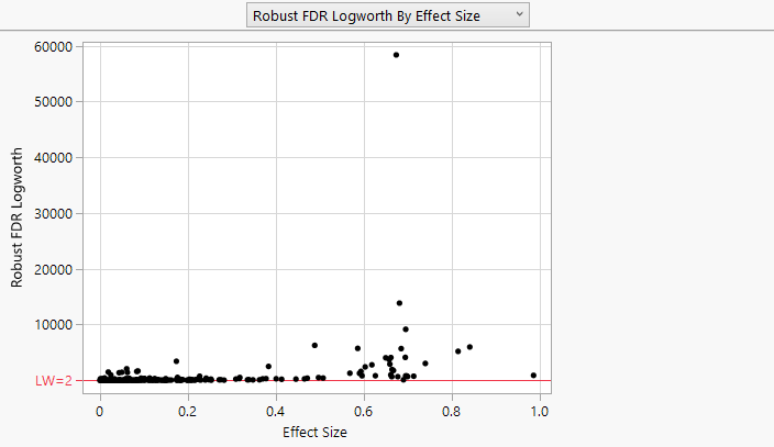

8. Click the Response Screening plot title list and select Robust FDR Logworth by Effect Size.
The detail in the plot is difficult to see, because of the one large Robust FDR Logworth value of about 58,000. To ensure that your graphs show sufficient detail, you can set a maximum value of the logworth.
Figure 24.10 Robust FDR Logworth vs. Effect Size, Max Logworth Not Set

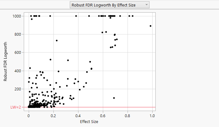

13. Click the Response Screening plot title list and select Robust FDR Logworth by Effect Size.
Now the detail in the plot is apparent. Robust FDR Logworth values greater than 1000 are plotted at 1000.
Figure 24.11 Robust FDR Logworth vs. Effect Size, Max Logworth = 1000
