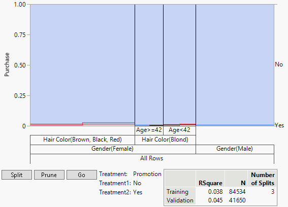

5. Below the Graph in the report that appears, click Go.
Based on the validation set, the optimal Number of Splits is determined to be three. Note that the left vertical scale is locked in order to maintain the overall rates of outcomes displayed on the right vertical axis.
Figure 6.2 Graph after Three Splits
The right hand vertical axis in the graph indicates that the proportion of purchases is small compared to non-purchases. The graph shows that uplift in purchases occurs for females with black, red, or brown hair and for younger females (Age < 42) with blond hair. For older blond-haired women (Age ≥ 42) and males, the promotion has a negative effect.

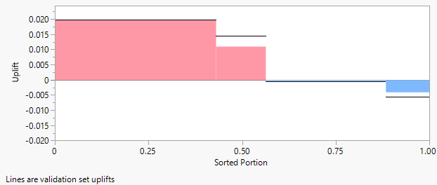

6. Click the Uplift Model for Purchase red triangle and select Uplift Graph.
Figure 6.3 Uplift Graph
Uplift Graph
Notice that for two groups of subjects (males and non-blond women in the Age ≥ 42 group), the promotion has a negative effect. The horizontal lines shown on the Uplift Graph delineate the graph for the validation set. Specifically, the decision tree is evaluated for the validation set and the Uplift Graph is constructed from the estimated uplifts.
