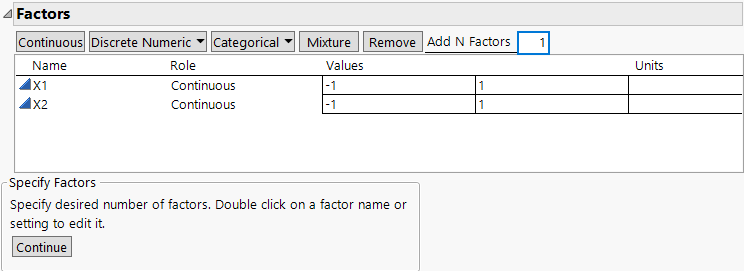

Add factors for a space-filling design in the Factors section.
Figure 22.6 Factors

The Factors section contains these options:
Continuous
Adds the number of continuous factors specified in Add N Factors. A continuous factor is a factor that you can set to any value between the lower and upper limits you supply, given the limitations of your process and measurement system.
Discrete Numeric
Adds the number of discrete numeric specified in Add N Factors. A discrete numeric factor can assume only a discrete number of values. These values have an implied order.
Categorical
Adds the number of nominal factors specified in Add N Factors. A categorical factor is either numeric or character data types. For a categorical factor, the value ordering is the order of the values as entered from left to right. This ordering is saved in a Value Order column property after the design data table is created.
Mixture
Adds the number of mixture factors specified in Add N Factors. A mixture factor is a continuous factor that represent ingredients in a mixture. The values for a mixture factor must sum to a constant. By default, the values for all mixture factors sum to one.
Remove
Removes the selected factors.
Add N Factors
Adds multiple factors of a given type. Enter the number of factors to add and click Continuous or Categorical. Repeat Add N Factors to add multiple factors of different types.

Factors Section
The Factors section contains the following columns:
Name
The name of the factor. When added, a factor is given a default name of X1, X2, and so on. To change this name, double-click it and enter the desired name.
Role
Specifies the Design Role of the factor. The Design Role column property for the factor is saved to the data table. This property ensures that the factor type is modeled appropriately.
Values
The experimental settings for the factors. To insert Values, click the default values and enter the desired values.
Units
The experimental units for the factors. To insert Units, click and enter the appropriate units.
Editing the Factors
In the Factors section, note the following:
• To edit a factor name, double-click the factor name.
• Categorical factors have a down arrow to the left of the factor name. Click the arrow to add a level.
• To remove a factor level, click the value, click Delete, and click outside the text box.
• To edit a value, click the value in the Values column.
