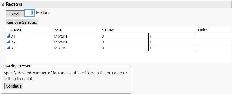

Add mixture factors in the Factors section.
Tip: When you have completed the Factors section, consider selecting Save Factors from the red triangle menu. This saves the factor names, roles, changes, and values in a data table that you can later reload.
Figure 14.3 Factors
Factors
Add
Enter the number of factors to add and click Add.
Remove Selected
Removes the selected factors.

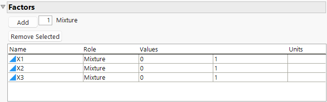

Factors List
The Factors list contains the following columns:
Name
The name of the factor. When added, a factor is given a default name of X1, X2, and so on. To change this name, double-click it and enter the desired name.
Role
Specifies the Design Role of the factor. The Design Role column property for the factor is saved to the data table. This property ensures that the factor type is modeled appropriately.
Values
The experimental settings for the factors. To insert Values, click the default values and enter the desired values.
Editing the Factors List
In the Factors list, do the following:
• To edit a factor name, double-click the factor name.
• To edit a value, click the value in the Values column.
