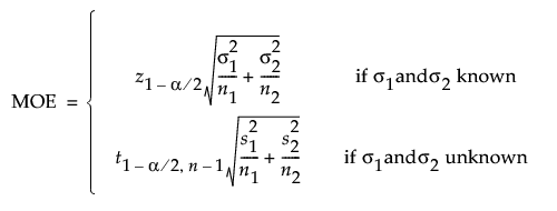

Statistical Details for the Margin of Error for Two Independent Sample Means Explorer
The interval calculations for capturing the difference in population means is based on the standard normal or t distributions based on whether σ1 and σ2 are known or unknown.
The margin of error (MOE) is calculated as follows:
Equation shown here

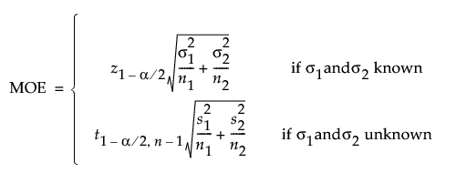

When σ1 and σ2 are unknown, the bounds are calculated as follows:
Equation shown here

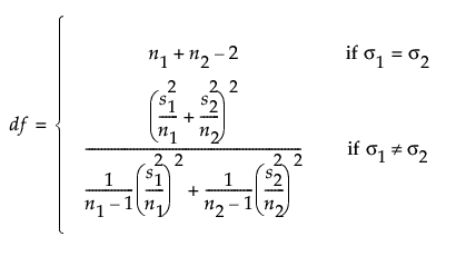

where
Equation shown here
When σ is known, the bounds are calculated as follows:
Equation shown here
