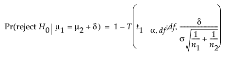

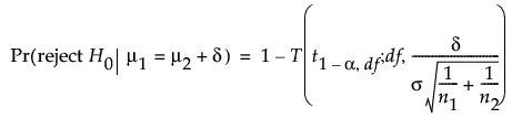

For the case when the group variances are unknown, it is assumed that σ1=σ2=σ and the power is calculated based on the form of the alternative hypothesis. For a one-sided, higher alternative (μ1 > μ2):
Equation shown here

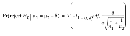

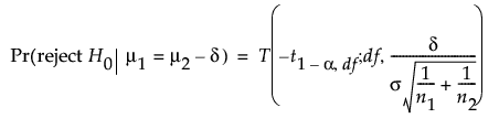

For a one-sided, lower alternative (μ1 < μ2):
Equation shown here

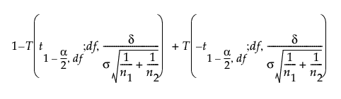

For a two-sided alternative (μ1 ≠ μ2):
Equation shown here
Equation shown here
where:
α is the significance level
n1 and n2 are the group sample sizes
σ is the pooled standard deviation
δ is the difference to detect
t1-α,ν is the (1 - α)th quantile of the central t-distribution with ν degrees of freedom
T(t; ν, λ) is the cumulative distribution function of the non-central t distribution with ν degrees of freedom and non-centrality parameter λ.
The degrees of freedom are approximate degrees of freedom, also known as Satterthwaite degrees of freedom:
Equation shown here

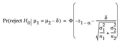

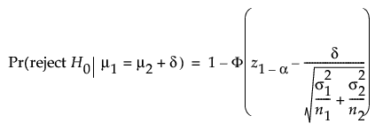

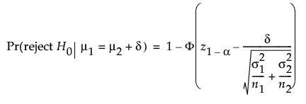

When σ1 and σ2 are known the z distribution is used for the power calculation. The power is calculated based on the form of the alternative hypothesis. For a one-sided, higher alternative (μ1 > μ2):
Equation shown here

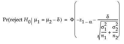

Equation shown here

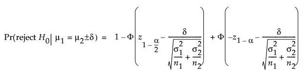

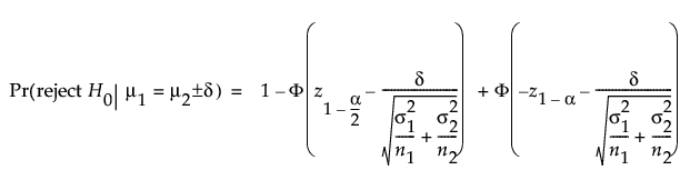

Equation shown here
where:
σ1 and σ2 are known group standard deviations
z1-α is the (1 - α)th quantile of the z-distribution
Φ(x) is the cumulative distribution function of the normal distribution.
