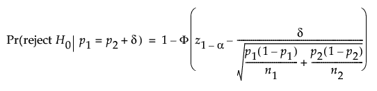

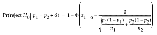

The power calculations for testing the difference in proportions from two sample groups are based on the normal approximation. The calculations depend on the form of the alternative hypothesis. For a one-sided, higher alternative (p1 > p2):
Equation shown here

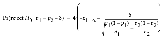

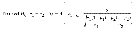

For a one-sided, lower alternative (p1 < p2):
Equation shown here

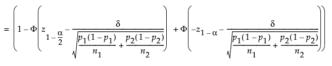

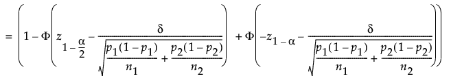

For a two-sided alternative (p1 ≠ p2):
Equation shown here
Equation shown here
where:
α is the significance level
n1 and n2 are the group sample sizes
p1 and p2 are the group proportions
δ is the difference to detect
z1-α is the (1 - α)th quantile of the distribution
Φ(x) is the cumulative distribution function of the normal distribution.
