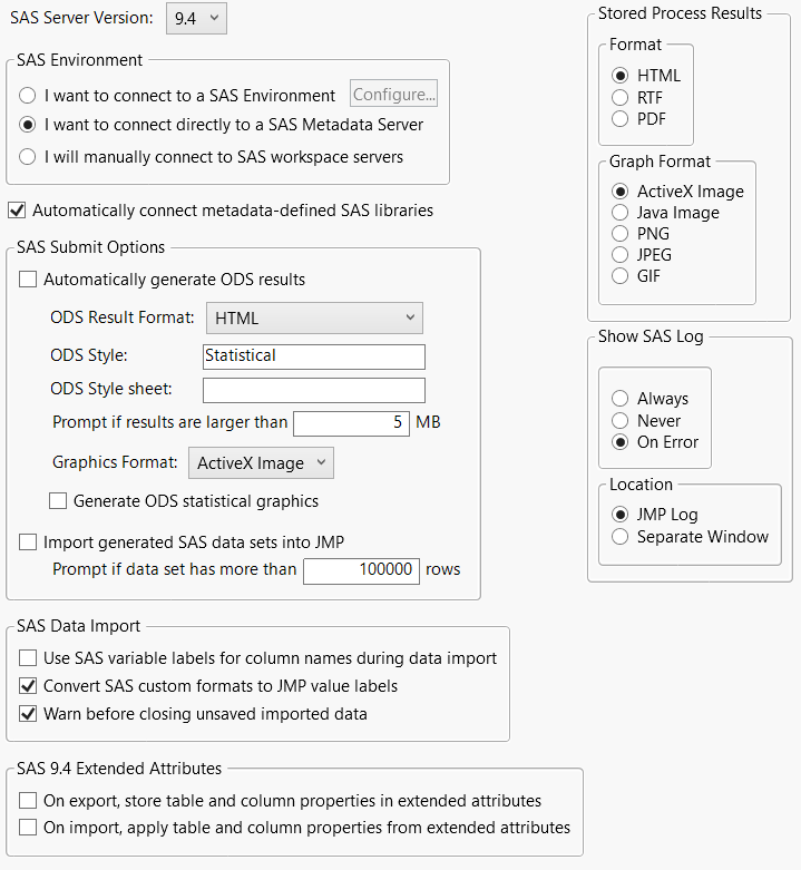

SAS Integration preferences customize the default settings for working with SAS servers. For more information about using the SAS Integration capabilities, see Import Data from SAS.
Note: The SAS Environment options appear after you select SAS 9.4 from the SAS Server Version list.
Figure 14.16 SAS Integration Preferences
Preference | Description |
SAS Server Version | Select the default version for the SAS Server. This can also be changed in the Server Connections window. (See Connect to a SAS Metadata Server from JMP.) This option does not apply when connecting to local SAS on Windows. The default setting is 9.4. |
I want to connect to a SAS Environment | Select this option to always connect to a SAS Environment and click Configure to configure the URL of the location. This option is deselected by default. |
I want to connect to a SAS Metadata Server | Select this option to always connect to a SAS Metadata Server. This option is selected by default. Clear this option if you do not have a SAS Metadata Server available, and you connect directly to SAS Workspace Servers instead. |
I will manually connect to SAS workspace servers | Select this option to manually connect to a SAS workspace server. This option is deselected by default. |
Automatically connect metadata-defined SAS libraries | Select this option to connect to metadata-defined SAS libraries automatically across all JMP sessions when you connect to a SAS Workspace Server. his option is selected by default. When the Workspace Server contains a large number of metadata-defined SAS libraries, deselect this option to speed up your connection to the server. |
Automatically generate ODS results | Select this option to generate output delivery system (ODS) results. This option is deselected by default. |
ODS Result Format | Select the format for ODS reports. The default setting is HTML. |
ODS Style | Enter the style name for ODS reports. The default setting is Statistical. |
ODS Style sheet | Enter the style sheet name for ODS reports. |
Prompt if results are larger than __ MB | Enter the number of MB that triggers a prompt for you to continue or cancel the operation. Five is the default setting. |
Graphics Format | Select the format for graphics for ODS reports. ActiveX Image is the default setting. |
Generate ODS statistical graphics | Select this option to include statistical graphics in the ODS reports. |
Import generated SAS data sets into JMP | Select this option to import any generated data sets into JMP automatically. |
Prompt if data set has more than __ rows | Enter the number of rows that triggers a prompt for you to continue or cancel the operation. The default setting is 100,000. |
Use SAS variable labels for column names during data import | Select this option to use the column labels in the SAS data set as the JMP data table column names when importing a SAS data set into a JMP data table. This option is deselected by default. |
Convert SAS custom formats to JMP value labels | Select this option to use the information in the SAS column formats to set JMP value labels when importing a SAS data set into a JMP data table. This option is selected by default. |
Warn before closing unsaved imported data | Select this option to trigger a prompt to save any SAS data sets that you imported into JMP and have not saved before closing. This option is selected by default. |
On export, store table and column properties in extended attributes | Select to allow extended attribute support during SAS 9.4 data export. This option is deselected by default. |
On import, apply table and column properties from extended attributes | Select to allow extended attribute support during SAS 9.4 data import. This option is deselected by default. |
Stored Process Results: Format | Select a report format: HTML (default), RTF, or PDF. |
Stored Process Results: Graph Format | Select a graph format: ActiveX Image (default, available only on a SAS server that runs on Windows), Java Image, PNG, JPEG, or GIF. |
Show SAS Log | Select Always, Never, or On Error (default) to set when the SAS log is displayed |
Location | Select the location for SAS log information: within the JMP log window, or in a separate SAS log window. The default setting is the JMP log window. |
