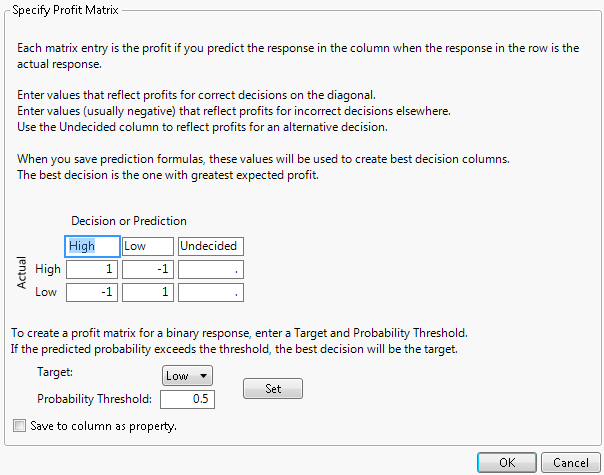

For categorical responses, you can specify a profit matrix in the Partition platform. A profit matrix is used to assign costs to undesirable outcomes and profits to desirable outcomes.
Figure 4.8 Specify Profit Matrix Window
You can assign profit and cost values to each combination of actual and predicted response categories. To specify the costs of classifying into an alternative category, enter values in the Undecided column. To save your assignments to the response column as a property, check Save to column as property. Leaving this option unchecked applies the Profit Matrix only to the current Partition report.
Probability Threshold Specification for Profit Matrix
When the response is binary, instead of entering weights into the profit matrix, you can specify a probability threshold in the Profit Matrix window. For more information about how values are calculated for the profit matrix, see Profit Matrix in Using JMP.
Target
The level whose probability is modeled.
A threshold for the probability of the target level. If the probability that an observation falls into the target level exceeds the probability threshold, the observation is classified into that level.
