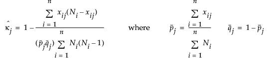

The individual category Kappa is defined as follows:
Equation shown here

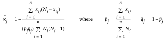

The overall Kappa is defined as follows:
Equation shown here

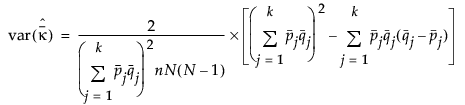

The variance of Equation shown here and Equation shown here are calculated as follows:
Equation shown here
Equation shown here
The standard errors of Equation shown here and Equation shown here are shown only when there are an equal number of ratings per part (for example, Ni = N for all i = 1,…,n).
