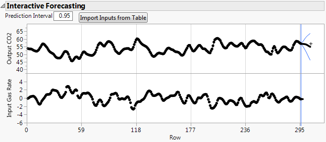

Interactive Forecasting
The Interactive Forecasting report provides a forecasting graph based on a prediction interval specified in the Transfer Function Model Specification window. The prediction interval around the prediction is shown in blue. Change the confidence level for this prediction interval by entering a number in the Prediction Interval box above the graph.
You can drag the plus sign in the graph to change the number of forecast periods in the graph. In the forecast periods, you can change the input values using the Import Inputs from Table button or by dragging points in the input graph to different values. The results of your changes are reflected in the forecast periods of the output graph.
Figure 18.14 Interactive Forecasting Graph
