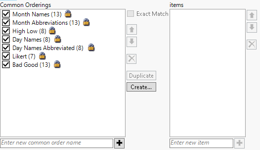

There is a built-in set of orderings (for example, month names, days of the week, and Likert) that automatically sort data. You can make customizations by adding new orderings, modifying previously created orderings, and disabling existing orderings.
Figure 14.12 Value Order Preferences
Preference | Description |
Exact Match | Specifies whether the items have to be exact matches, including case and whitespace. This option is deselected by default. |
Duplicate | Creates a copy of the selected ordering that you can modify. |
Create | Select a column from the current table and create an ordering. |
