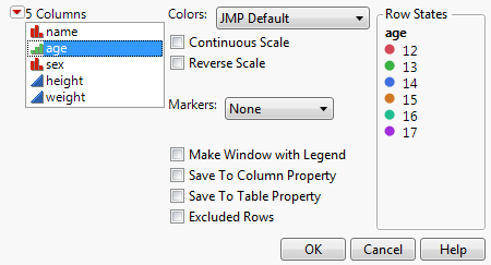

3. In the window that appears, highlight the column whose values you want to color or mark. A preview of the legend is shown on the right.
Figure 9.24 Adding a Row Legend
Adding a Row Legend
4. Refine your row legend using the following options:
Colors
Lets you choose among several pre-defined color schemes.
Tip: If you already applied a color scheme in the data table, select None to maintain it. Colors should be consistently applied and uniquely grouped.
Continuous Scale
Assigns colors on a spectrum that corresponds to the ascending or descending order of the values. Use this option when the highlighted column contains continuous values.
Reverse Scale
Reverses the scale of colors.
Markers
Lets you choose among several marker schemes.
Tip: If you already applied a marker scheme in the data table, select None to maintain it. Markers should be consistently applied and uniquely grouped.
Make Window with Legend
Creates a separate legend window that tells you what colors and shapes correspond to which value.
Save to Column Property
Adds a column property that stores the selected color theme.
Save to Table Property
Adds a table property that preserves the selected color and marker configuration.
