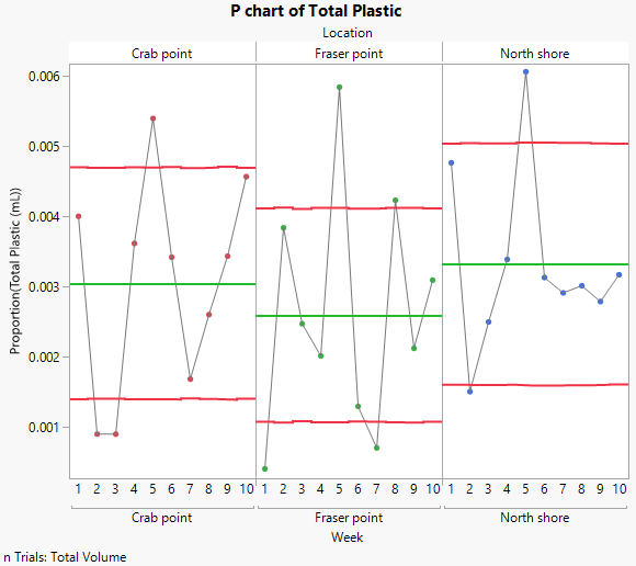

Figure 3.24 Standard P Chart for Water Plastics
There are several points on the standard P chart that are labeled as out of control. Due to how control limits are calculated in the standard P chart, there is a strong possibility that the out of control points are actually false alarms. Compare these results to the results from the Laney P′ chart.

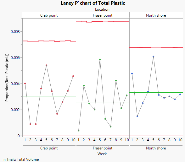

Figure 3.25 Laney P′ Chart for Water Plastics
Laney P¢ Chart for Water Plastics
Unlike the standard P chart, the Laney P′ chart displays all of the points as in control for this data set.
