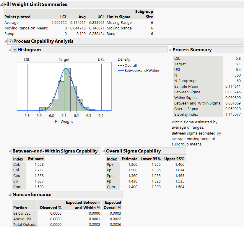

Figure 3.34 Three Way Control Chart for Fill WeightÂ
A Moving Range chart appears between the Range and Average charts. The limits on the Average (XBar) chart are now calculated using the moving range between each sample.
