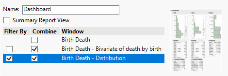

3. From one of the report windows, select Window > Combine Windows.
The Combine Windows window appears.
Tip: On Windows, you can also select Combine Windows from the Arrange Menu option in the lower right corner of JMP windows.
4. Select Summary Report View to display the graphs and omit the statistical reports
5. In the Combine column, select Birth Death - Bivariate of death by birth and Birth Death - Distribution.
6. In the Filter By column, select Birth Death - Distribution.
Figure 7.18 Combine Windows Options
7. Click OK.

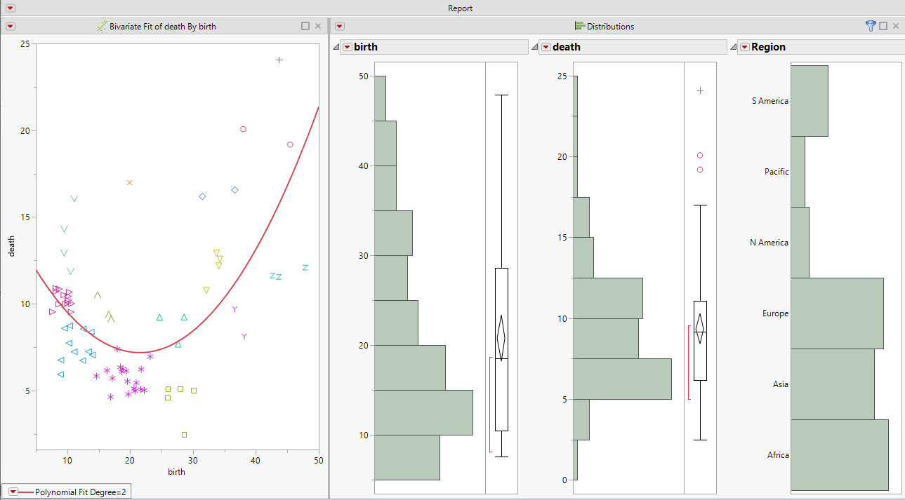

The two reports are combined into one window. Notice the filter icon Image shown here at the top of the Distribution report. When you select a bar in one of the histograms, the resulting Bivariate graph displays the selected data.

• To see statistics with the graphs, from the red triangle menu, select Report View > Full.
Figure 7.19 Combined Windows
Combined Windows
