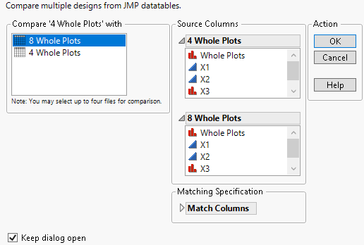

3. In the 4 Whole Plots table, select DOE > Design Diagnostics > Compare Designs.
4. From the Compare ‘4 Whole Plots’ with list, select 8 Whole Plots.
A panel for this design is added to the launch window. JMP automatically matches the columns in the order in which they appear in the two design tables.
Figure 17.13 Completed Launch Window
5. Click OK.

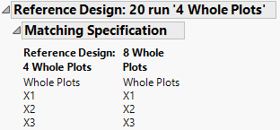

6. Open the Matching Specification section under Reference Design: 20 run ‘4 Whole Plots’.
Figure 17.14 Matching Specification for Split-Plot Designs
Notice that the Whole Plots column is entered as part of the design. This is necessary because Compare Designs needs to know the whole plot structure.

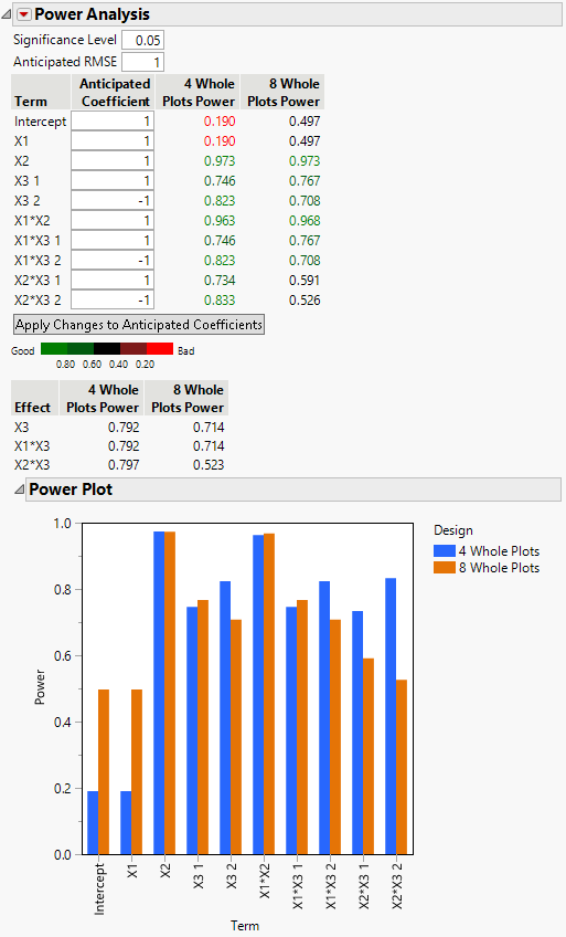

Figure 17.15 Power Analysis for Two Split-Plot Designs
The Power Analysis report shows that the power for the whole-plot factor, X1, is much smaller for the four whole-plot design (0.19) than for the eight whole-plot design (0.497). However, the four whole-plot design has higher power to detect split-plot effects, especially the interaction of the two split-plot factors, X2*X3 (0.797 compared to 0.523). Notice that the power for the combined effect X2*X3 is given under the color bar and legend.
