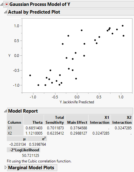

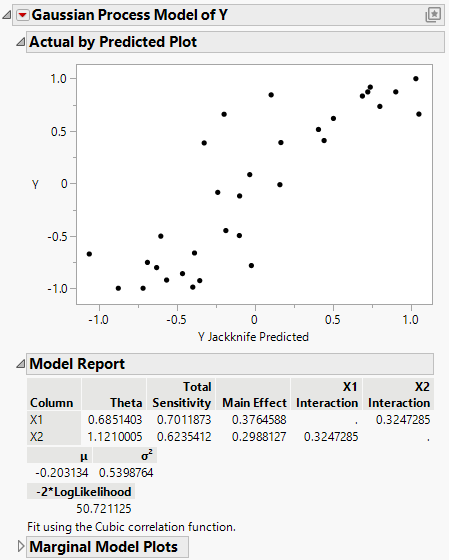

Figure 17.2 Gaussian Process Report
Note: The estimated parameters can be different due to different starting points in the minimization routine, the choice of correlation type, and the inclusion of a nugget parameter.

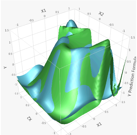

12. In the Dependent Variables section below the plot, in the Surface column, select Both sides for the Y Prediction Formula. This plots both Y and the Predicted Y on the same surface.
Figure 17.3 3D Surface Plot of the Actual and Predicted Ys
The two surfaces are similar. The impact of X1 and X2 on the response Y can be visualized. You can click and drag to rotate the plot to view it from different angles. Marginal plots are another tool to use to understand the impact of the factors on the response.
