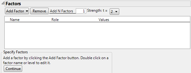

Add covering array factors in the Factors section.
Figure 21.17 Factors
Factors
Add Factor
Enters the number of factors specified in Add N Factors. All factors are categorical. Select or specify the number of levels.
Remove
Removes the selected factors.
Add N Factors
Adds multiple factors with a specific number of levels. Enter the number of factors to add, click Add Factor, and select or specify the number of levels. Repeat Add N Factors to add multiple factors with different numbers of levels.
Strength t =
Select a value to specify the strength of the array.
Tip: When you have completed your Factors panel, select Save Factors from the red triangle menu. This saves the factor names and values in a data table that you can later reload. See Covering Array Options.
