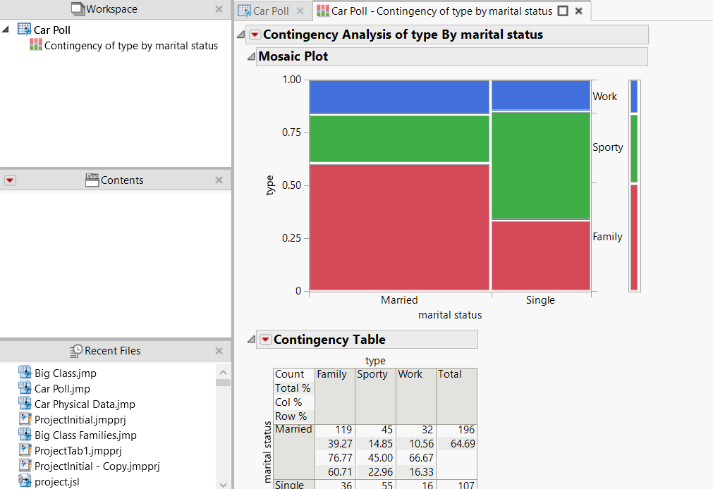

Figure 10.22 Initial Project
Initial Project
