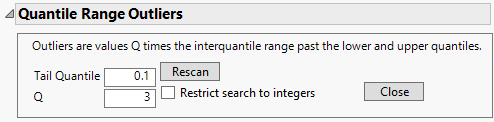

The Quantile Range Outliers controls enable you to specify how outliers are to be identified. An outlier is considered any value more than Q times the interquantile range from the lower and upper quantiles. You can adjust the value of Q and the size of the interquantile range.
Figure 21.6 Quantile Range Outliers Initial Options
Tail Quantile
The probability for the lower quantile that is used to calculate the interquantile range. The probability of the upper quantile is considered 1 - Tail Quantile. For example, a Tail Quantile value of 0.1 means that the interquantile range is between the 0.1 and 0.9 quantiles of the data. The default value is 0.1.
Q
The multiplier that determines the outlier threshold. Values that fall beyond Q times the interquantile range past the Tail Quantile or 1 - Tail Quantile values are identified as outliers. Large values of Q provide a more conservative set of outliers than small values. The default is 3.
Restrict search to integers
Restricts outlier values to only integer values. This setting limits the search for outliers in order to find industry-specific missing value codes and error codes.
Rescan
Rescans the data after outlier actions have been taken.
Tip: Press Ctrl and click Rescan to rescan across all open outlier methods.
Close
Closes the Quantile Range Outliers report.
Tip: Press Ctrl and click Close to close all outlier reports.
