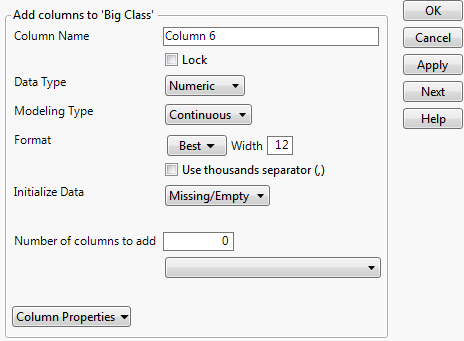

Figure 5.2 The Column Info Window
The Column Info window contains the following information:
