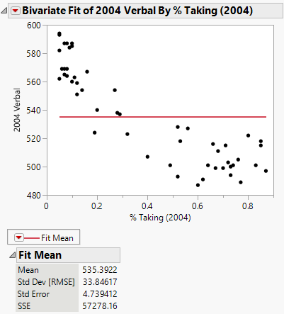

The Bivariate Fit red triangle menu contains display, fitting, and control options. Each fitting option adds a line, curve, or distribution to the scatterplot, a red triangle menu for the fit below the plot, and a fit-specific report to the report window.
Figure 5.5 Example of the Fit Mean Option
