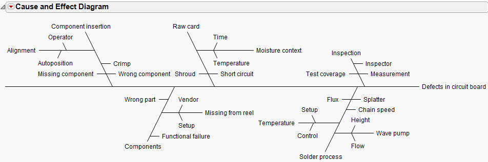

Use the Diagram platform to construct cause-and-effect diagrams, also known as Ishikawa charts or fishbone charts. Use these diagrams to:
• Organize the causes of an effect (sources of a problem)
• Brainstorm
• Identify variables in preparation for further experimentation
Figure 16.1 Example of a Cause-and-Effect Diagram
