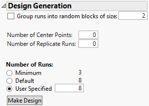

Figure 4.23 Design Generation
Design Generation
Design Structure Options
Group runs into random blocks of size

Number of Runs Options
Minimum
A lower bound on the number of runs necessary to avoid failures in design generation. When you select Minimum, the resulting design is saturated. There are no degrees of freedom for error.
Note: If you select the Minimum number of runs, there will be no error term for testing. You will not be able to test parameter estimates. This choice is appropriate only when the cost of additional runs is prohibitive.
Default
Suggests the number of runs. This value is based on heuristics for creating a balanced design with at least four runs more than the Minimum number of runs.
User Specified
Specify the number of runs that you want. Enter that value into the Number of Runs text box. This option enables you to balance the cost of additional runs against the potential gain in information.
Number of Runs
This is the only option that appears when a covariate factor with Changes set to Easy is specified. The number of runs shown is the number of rows in the data table associated with your covariate or covariates. You can specify a smaller number of runs. In that case, the covariate runs that are selected optimize the design criterion.
Make Design
Once you have completed the Design Generation section, click Make Design. Custom Design generates the design, presents it in the Design section, and provides evaluation information in the Design Evaluation section. Notice the controls in the Model and Alias sections are disabled. Use the Back button to change model or alias terms. The Output Options panel also appears, enabling you to create the design table.
