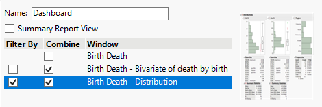

4. Select Summary Report View to display the graphs and omit the statistical reports
5. In the Combine column, select Birth Death - Bivariate of death by birth and Birth Death - Distribution.
6. In the Filter By column, select Birth Death - Distribution.
Figure 11.13 Combine Windows Options
7. Click OK.

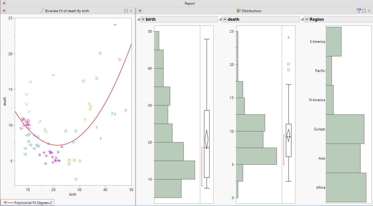

The two reports are combined into one window. Notice the filter icon Image shown here at the top of the Distribution report. When you select a bar in one of the histograms, the resulting Bivariate graph displays the selected data.

• To see statistics with the graphs, from the red triangle menu, select Report View > Full.
Figure 11.14 Combined Windows
Combined Windows
